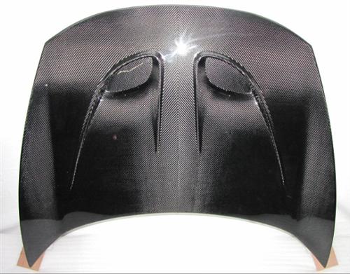

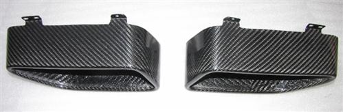

For a pre-peg the weave seems a little wavy on a simple item like the tailpipe finishers. I don’t see any added notes to deal with the heat effects to the resin for that application
I am a little suspect of the "ram air" version of the rear circumference vent, pic. 1. The upper 1/2 of the panel that sits over the x-pipe or resonator is covered. This could be a big issue especially under excess use and long idling where heat load builds. Also no notes about temp issues in a 400+/- degree area.
