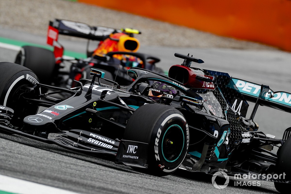

Before I could make a firm decision on what I believe DAS is being used for, I would need to see if it was only used during the warm-up laps or used periodically during the race.
During Friday practice, it was being used on warm-up and cooldown laps but that might just be to check the function. We will need to wait until push comes to shove later in the weekend to see when Mercedes uses it on the days that count.
If used on warm-up laps then my opinion is that it is for front tyre heating. The front tyres are always difficult to get up to temperature for that one lap in qualifying.
If used during the race then it could be for many things. This includes reducing the overheating of the inner shoulder of the front tyre, reducing tyre drag on straight and, again, reducing front tyre temperature.
Mercedes F1 DAS Austria 2020
It could even be improving straightline speed or changing the airflow characteristics spilling off the front tyre contact patch. This, in turn, could alter how the underfloor works. If this can stall the underfloor and diffuser airflow, the straightline speed advantage will be significant.
Red Bull’s argument is that its primary purpose isn’t to steer the car. That’s Red Bull’s opinion and I probably agree, but it will only be deemed illegal if the Mercedes argument to the FIA was that its sole purpose was to steer the car.
If this is the case then Mercedes will need to satisfy the FIA that the other changes that happen when it is used are insignificant to the car’s overall performance. That’s going to be difficult to achieve.
