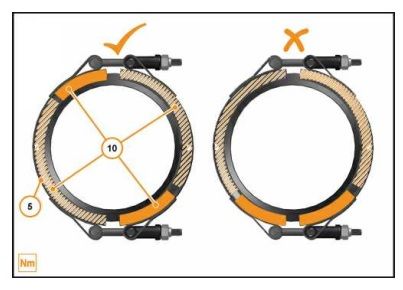

Note about reinstall of v-band orientation:

If the shop knows what they are doing, then it doesn't take anywhere near 6 or 10 hours to do this. The shops are charging wayyy too much. The biggest pain is putting on the heat shields and that stupid fake vband clamp pictured above.
