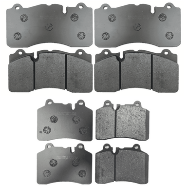

#1 · (Edited)
Brake Pad Replacement:
CCB Rotor Replacement:
Caliper Replacement:
Rebuilding OE Calipers:
