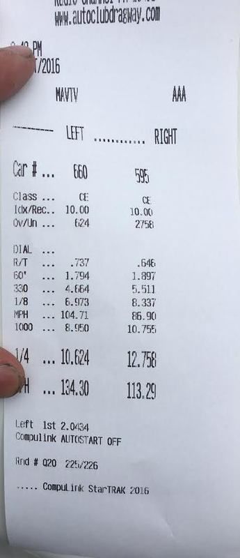

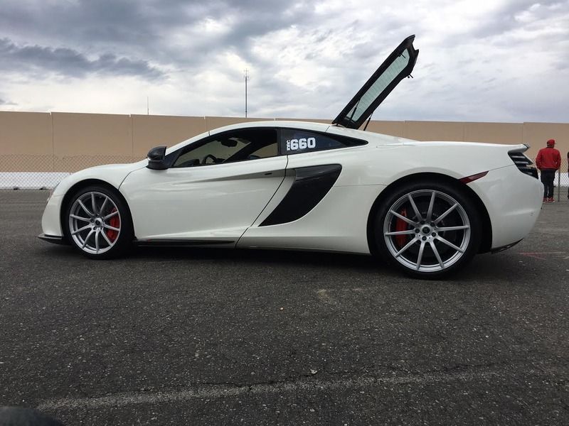

Will be going to the track this weekend to see what the car does on the new tune. I've taken some torque out of the low end in hopes of getting some traction off the line. Car went 10.6@134 bone stock with a bad 60' on the same track so that is my baseline. I expect to see it do a 140+ trap this time around. Here was a live video feed of when I had the car on the dyno. No tuning was done on the dyno, strictly road tuned by feel and lots of data logging. Only went on the dyno for a magazine feature and we will have it back on their shortly to see how much more it can pick up from the downpipes.

Nice! Did I see that correctly in the video? 100 hp added with just a tune on a 650S? Curious, if there is another 100 hp with just a tune on the 650S, why are none of the other tuner companies offering similar gains?
There is normally a safe tight clustering of gains when it comes to tunes on the same model.
